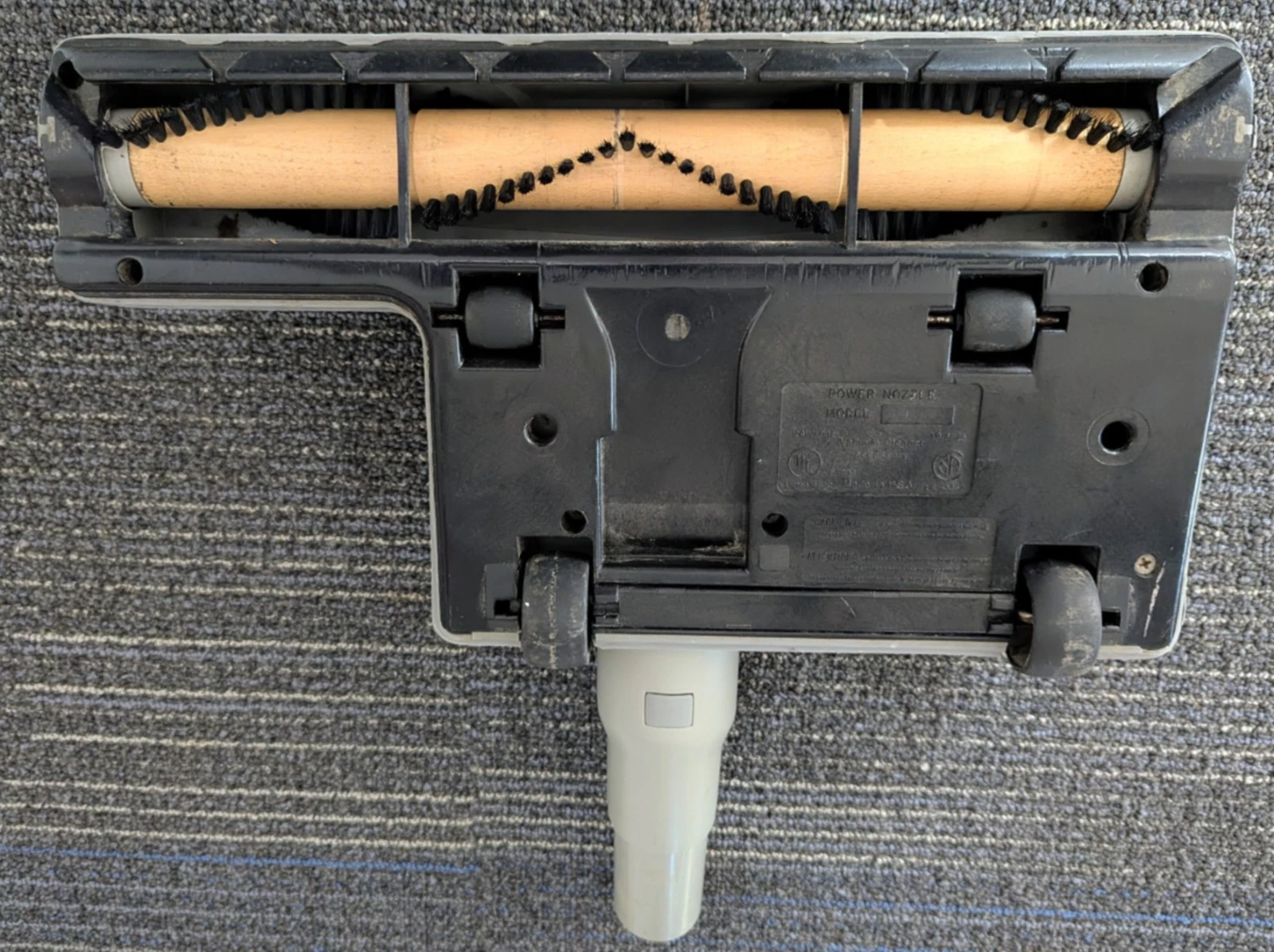

The solution is not to turn the power down but to get some air under the nose of the nozzle. Peak under the nose of most Kenmore, Panasonic, old US Electrolux ( now Aerus ), old Singer Twin Fan and modern Commercial Hoover uprights and canister power nozzles. You will see the noses of the nozzle base are serrated to let air get underneath. You want air moving under there. Panasonic even designed a really cool power nozzle that is now made by Suzhou Cleva Electric Appliance Co Ltd for sale by Kenmore, Titan and Cen-Tec Systems that Kenmore calls the Ultra Plus Nozzle ( Panasonic called it Plush Pro when sold with their house brand vacuums ). Cen-Tec calls it the CT-25. This nozzle was designed to address latching on the increasingly plush deep pile carpets popular in North America and the necessity of using high power settings or central vacuums to clean them. It has reed valves on top of the body that feed small air vents positioned right in front of the brush roll. If the nozzle starts to latch due to high suction the reed valves are pulled open, drawing air in and under the nose. These nozzles are effortless to push, and clean carpets very well. You want to have air getting in under the nose to move the dirt up out of the carpet and into the airstream to the hose and dust bag.
In decades past vac shops accomplished much the same thing with power nozzles that had a flat metal sole plate ( Eureka and Tristar for example ) by drilling a line of small holes across the front edge of the sole plate right in front of the nozzle opening. Tristar even started to make their 2-1000 power nozzles that way from the factory. Sebo recently started to do the same on one of their upright vacuums. What's old is new again ! But it works.
Both achieve a reduction in head pressure. Reducing motor power is more efficient and less wasteful when possible. You can run through the basic maths yourself.

Here is a link to an image of one of the all time great power nozzles. Notice how many notches are in the nose of the nozzle base to let air get in under the rotating brush. Note the two deep side channels that angle in from the front corners. The wooden brush roll is durable and never overheats, warps or melts. Height adjustment is passive, the rear wheels are spring loaded. This is a design that dates to 1985 or 86 and continues in production to this day. Great designs never die.
https://i.ebayimg.com/images/g/I-4AAeSwbGRpERPK/s-l1600.webp
Here is an image of the newly released bottom plate for the Sebo X7. You can see three air holes in front. This is new, designed to prevent the nozzle from latching by letting some air in under the rotating brush, a change necessitated by the deeper pile plush carpets becoming more popular in the US. Sebo ET-1 power nozzle already had this feature for a while. Earlier sole plates for Sebo G and X series uprights are solid, no holes. Most Sebo uprights are single speed btw. The Felix and one upright with a "Turbo" feature are the exceptions. Everything else is single speed, full power all the time.
https://s.turbifycdn.com/aah/yhst-76587561205955/sebo-x7-front-bottom-plate-50404gser-19.gif
Here is the old school remedy for power nozzles latching on deep pile carpets for vacuums that are single speed like Compact and Tristar. Drill a line of holes in the nose of the sole plate. Tristar eventually started making them this way. This is the inspiration for the holes in the Sebo sole plate.
Turning the power down when the carpet is deep is the wrong choice. All wrong. Get some air under the nozzle !
https://i.ebayimg.com/images/g/QrcAAeSwTuBo5Um3/s-l1600.jpg
