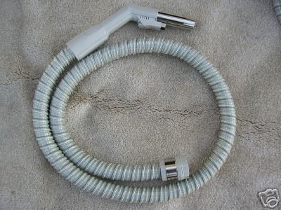

<span style="font-family: georgia,palatino;">I noticed that the generic electrified hose is a foot longer than the genuine Lux hose; in addition to the generic hose having a ON/OFF switch for PN & sliding suction control valve.  I ordered a new generic hose (the one that resembles genuine Lux hose) because my Epic 6000 didn't have any tools or hose.  However, I have the original color tools & PN; but I will order another SideKick or Wessel Werk HEB160 later</span>
<span style="font-family: georgia,palatino;"> </span>
<span style="font-family: georgia,palatino;">Generic Lux hose that resembles genuine Lux hose</span>

On the generic hose....
Look at the electrical connection for the power nozzle and side kick. It is longer, I could not use my sidekick on it.....I don't know if it could be adjusted or not.
Bud
I bought the generic hose and have no problems using my Sidekick with it. I bought it to use with my Lux '89 because the woven hose had too much leakage. I removed the connection at the tank end and replaced it with the connection from my '89 hose.
Gary
I have that generic hose for my Diamond Jubilee but I don't like it as much as the genuine Lux hose. The one I have is the same length as the genuine hose. I do notice that the electrical connection on the end of the hose does seem longer then the genuine lux hose and I did adjust the cord inside of the wand sheath. My biggest issue with the generic hose is the annoying suction relief valve. It seems to open very easily and the slightest bump of the hose and it seems to come open. I feel like I'm always closing it whenever I use that machine. The switch on the handle is a nice feature but I'd rather have the round suction control wheel then the switch. Also the plastic hose handle is not even close to the quality of the Lux hose. I know these aren't huge issues and probably not enough of a problem to justify the added cost of a genuine Lux hose over the generic, but if I could go back in time I would have spent the extra money and bought the genuine Lux hose.

On my Epic 6500 - It has a generic hose.......And it's fine........BUT.....I have always had a slight problem, and I don't know if it's the fact that it's a generic hose, or if a regular LUX hose would do the same thing....
Where the hose connects to the canister, when you're vacuuming along and pulling it, sometimes you hear the hissing sound, as if it isn't tight enough connecting to the canister, so you have to jiggle the hose and it stops. I've learned to deal with it while vacuuming. Funny because the connecting to the canister is pretty secure and on correctly...it gets worse as the bag fills....When a fresh bag is in, it's not nearly as bad.

I purchased a generic Lux hose about 7 years ago for my Diamond Jubilee from ESSCO, which looks very much like the genuine hose. It doesn't swivel nearly as well, is not made with anything close to the same quality of materials as the lux hose, and not only does it not swivel as we'll but the poorly designed suction relief valve opens constantly. If I knew what this hose was going to be like I would have gladly paid the extra money for the genuine hose, no questions asked.
I've not been happy with my generic hoses. The generic hose on my Diamond Jubilee has a broken release mechanism. It was previously stuck on the machine for 7 years, but I was recently able to man-handle it loose. I bought a better-looking generic on Ebay a few days ago. If it also has a screwed-up release, I'll go to Aerus and buy a quality replacement OEM hose.
The Epic 6000 I own also has a generic hose. As others have said, it makes a "woosh" sound when you pull on the hose, meaning the generic hose has an air leak at the inlet on the machine due to poor fit.
I can verify that attaching my brand new 2015 Lux Legacy hose to my 6000 fixes that sound, so it's all in the hose. I may eventually replace it, too.
