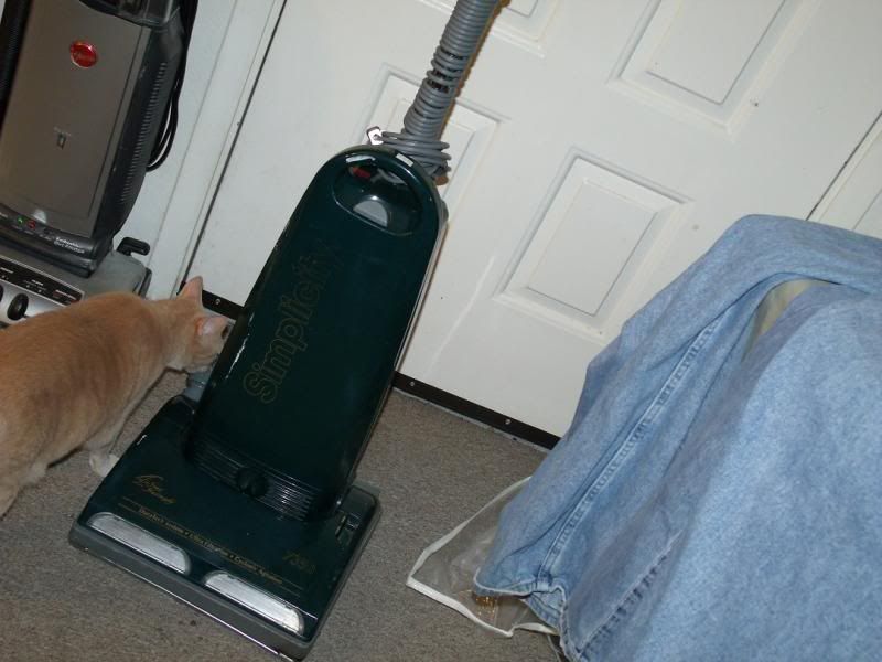

Nice Simplicity! Other than the decals being a little scratched up, it appears to be in good cosmetic condition. Does this one have the metal bottom plate?
got it home...

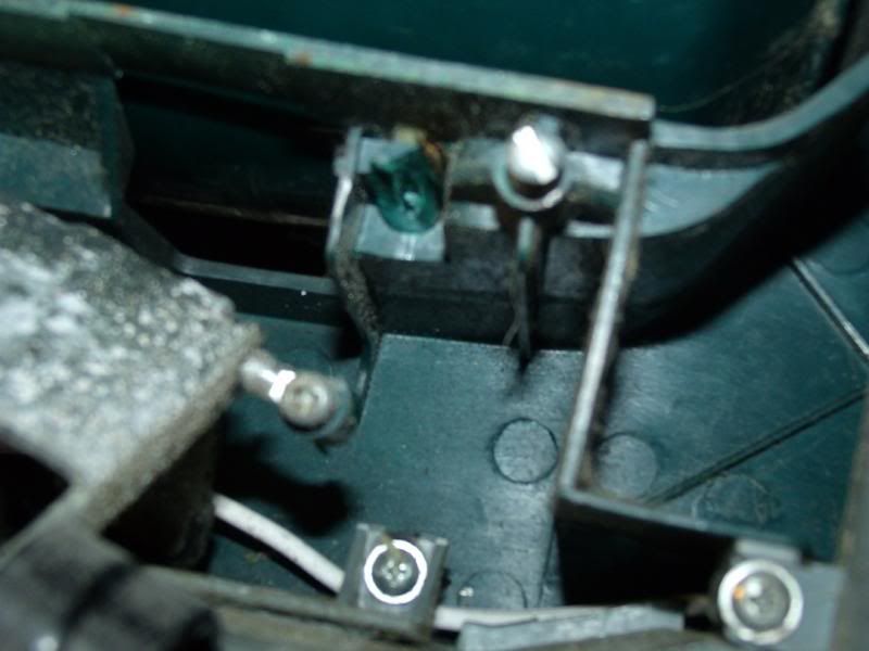

I got the thing home and started exploring it.  There are a few problems... both head lights are burned out, the plastic that front wheels screw into is broken, the belt has a hole in it, and it smells to high heavens of dog...  Only missing the upholstery tool and lower cord hook.
I haven't gotten to play with it yet because of the bad belt and smelly bag, but I did fix the broken plastic screw holder with plastic epoxy.  Someone had already done it on the other side because I see JB Weld there....  Must be a weak spot/design flaw... this thing has obviously had a hard life, but that's all over with now :o)  Hopefully it isn't scarred too badly from the abuse from the past and will become a contributing member of the vacuum family.  Spa treatment to ensue.
This is how I found it with the cord wrapped around the handle.  The cat had to come see what it was as soon as I brought it in the house.

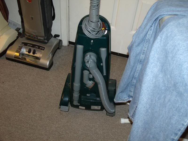

The back...  Only missing the upholstery tool.  So glad that the handle release pedal works.
Here's the problem... The screw holder was broken.  I wonder how common this was on these.   I used plastic epoxy and that usually fixes this...
I had to use it on my Windsor Sensor 12 when I got it too as it had the same problem.  Maybe it's just high end vacuums that do this!
You can see the plastic stuck the the screw... that is not supposed to be separate from the vacuum!
The other side that someone has obviously fixed with JB Weld...

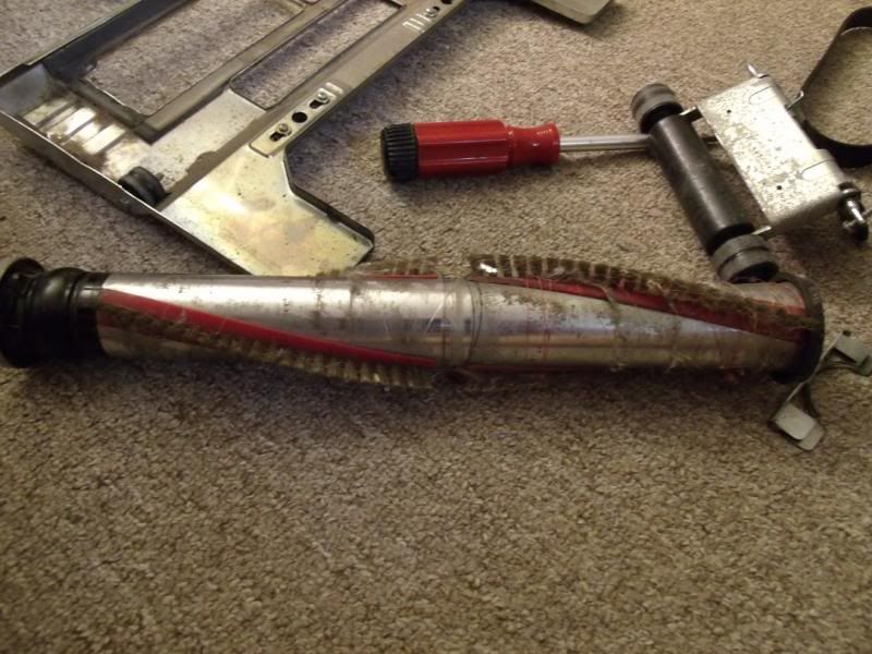

The brushroll.  It spins freely, and while I wouldn't exactly call it clean, I've seen worse.

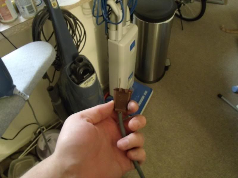

The replaced plug.  I'm going to have to play with this.  The cord isn't inserted far enough in and there is a gap between the cord end
and the plug where insulation is coming out.  It says "spring action" on it, so I'm not sure how comes off... but I like it better than the
kind I've seen before that screw together because it has a cord clip on it.

from the picture if the brushroll is in good enough shape to not need to be replaced yet?  It seemed to extend past the bottom plate and
spun freely, so I'm thinking that a clean up might be all it needs, but you would know better than me since you are around these things all
day every day.

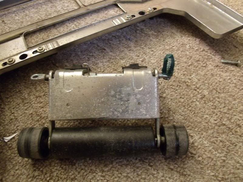

The 7350 has had a rough life, but there's still a LOT more left in the old guy. You'll notice that the wheel assembly has the marks on the outbound wheels where the axel was bent and they rubbed against the sole plate as the machine was moved back and forth.
The brush roller's hole for the linkage rod should be UP, while the 'forked tongue' is DOWN. Many times the forked tongue and the hole for the linkage rod and both UP and that would make the brush roller not shut off in the bare floor position.
Your brushes look good. New bristle strips are not expensive (less than $15).
Here's a photo of how the brush positions should be when replacing it into the machine. And also how the wheel carriage and wheels 'should' look.
forked tongue down, linkage hole up
They should be at opposite ends, but it's easy to turn them so they're both facing the same direction - which is the problem with most of the ones I've seen where someone changed the belt but didn't understand 'how'.
