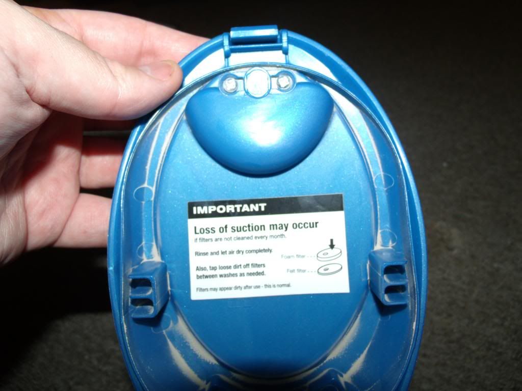

The first filter is just filthy on the top, but the bottom of it looks like brand new... and I wanted to share the instructions on the lid that goes over the filter...

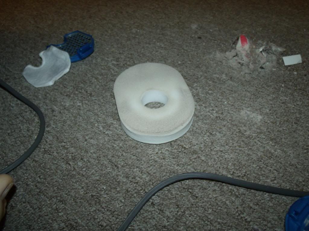

The pile in the background is what it got up on the second use... the little filter and end cap is what blew off.

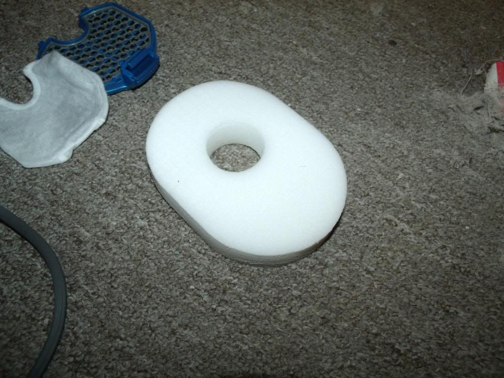

This is the clean part of the filter... this is what the top part looked like before 2 uses... now it looks like the above picture!

yeah...those after filters on sharks always get dirty...its not exactly dirt, mainly just carbon dust
All the dirt that the single cyclone doesn't separate from the air, goes directly to the filter. On a proper cyclonic machine, that dust would be separated by the high efficiency cyclones. Shark's "no loss of suction" claim cannot be taken as accurate. In the test to be able to claim 'no loss of suction', the machine only has to inhale on bin full of dirt. As long as the suction and airflow change no more than 5%, they can make the claim. Most Shark owners do not clean their filters often, if at all. I can imagine how hot that tiny little motor will get when the filters are dirty.
