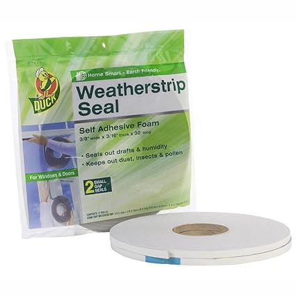

It looks like the rubber strip is perished and failing. You'd have to wash the plastic shield and clean it all up, remove old residue from past attempts, remove the rubber seal, and replace with a new one. You cannot find that part online, not sure if a mom and pop shop might have it.
There are these two motor gaskets for a DAM vacuum on eBay, which should work, as it looks to be the same type of gauge of rubber, might have to buy a couple to get them to fit the whole part.
https://www.ebay.com/itm/Hoover-Dia...405054&hash=item41e2188114:g:eCsAAOSwWfda-e7O
https://www.ebay.com/itm/Hoover-Dia...404696&hash=item41e2188132:g:cUkAAOSwDZ1a-fAK
The foam parts should be able to be replaced with weatherstrip foam:
https://images-na.ssl-images-amazon.com/images/I/61rEzvmyI3L._SX425_.jpg
