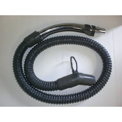

I have this old Kenmore Canister of my grandparents. I believe it's from the mid to late 60's or early 70's (correct me if I'm wrong). I've had it for a few months now, and am just finally posting about it here. I used it once, and the suction was decent for a vacuum that survived two basement floods, the motor did whine a little, but it had no burning smell. The biggest problem I have with it however is that the hose has plenty of cracks in it and is being held together by packing tape (as seen in the photos below. So, would a replacement hose be easy to find (it doesn't have to be an exact replacement) and is it worth having as a project to fix in my spare time? Also, is it a rare vacuum?

I've come to the assumption that it just isn't worth fixing this thing. The 2 prong Kenmore Canister hoses I and another person who replied to this thread found online have prongs that are too wide for this and the motor while still working is pretty rusty. My throat is also burning from breathing in after opening this thing up after so many years, as I think the inside had some mold in it from one of the floods it survived. It had a great run, but I think it's time for her to go to vacuum heaven. :(
