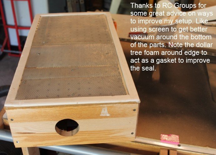

I have seen people making similar things for vacuum-forming plastic hobby projects, nearly the exact same construction - so it seems like a similar concept - just going the opposite way when you are testing with vacuums.
https://s3.amazonaws.com/assets.flitetest.com/article_images/full/pic7-jpg_1412404560.jpg
https://cdn.instructables.com/F2A/ZJ4T/IQ2KKFAC/F2AZJ4TIQ2KKFAC.LARGE.jpg
